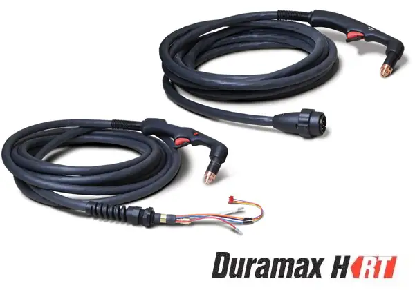

Duramax HRT hand torches with and without quick disconnect
Duramax HRT hand torch with quick connect   Duramax HRT hand torch without quick connect
Torch assemblies
Consumables, operator manual and consumables sticker for your system included.
Part number Description - Systems
228916 HRT hand torch assembly, 7.6 m (25') leads - Powermax600, Powermax800, Powermax900, MAX42, MAX43
228917 HRT hand torch assembly, 15.2 m (50') leads - Powermax600, Powermax800, Powermax900, MAX42, MAX43
228918 HRT hand torch assembly, 7.6 m (25') leads* - Powermax600 CE
* Without quick disconnect
