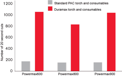

More consumable life
Conical Flow™ nozzle and Spring electrode give you up to 6 times longer consumable life than standard PAC121, PAC123 and PAC125 torches and consumables – reducing consumables costs by up to 30%
For even greater savings, CopperPlus™ long life electrodes provide dramatically longer service life than standard consumables when cutting metal 1/2" and under.

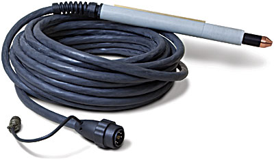

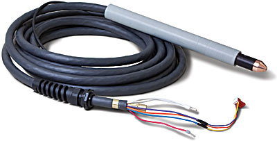

Duramax MRT mechanized torches with and without quick disconnect
Duramax MRT mechanized torch with quick connect  Duramax MRT mechanized torch without quick connect
Torch assemblies
Consumables, operator manual and consumables sticker for your system included.
Part number Description - Systems
228920 MRT machine torch assembly, 7.6 m (25' ) leads - Powermax600, Powermax800, Powermax900, MAX42, MAX43
228921 MRT machine torch assembly, 15.2 m (50') leads - Powermax600, Powermax800, Powermax900, MAX42, MAX43
228922 MRT machine torch assembly, 7.6 m (25' ) leads* - Powermax600 CE
*Without quick disconnect

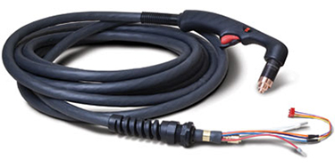

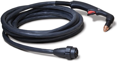

Duramax HRT hand torches with and without quick disconnect
Duramax HRT hand torch with quick connect   Duramax HRT hand torch without quick connect
Torch assemblies
228916 HRT hand torch assembly, 7.6 m (25') leads - Powermax600, Powermax800, Powermax900, MAX42, MAX43
228917 HRT hand torch assembly, 15.2 m (50') leads - Powermax600, Powermax800, Powermax900, MAX42, MAX43
228918 HRT hand torch assembly, 7.6 m (25') leads* - Powermax600 CE
* Without quick disconnect
