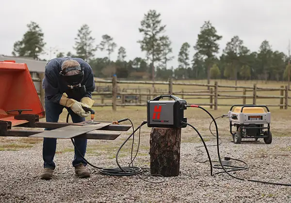

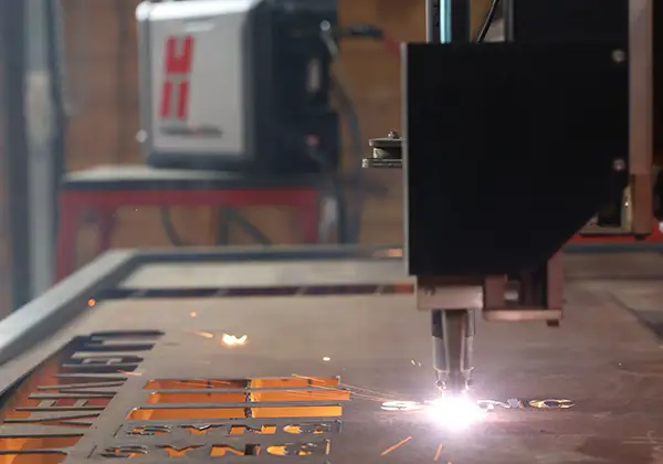

Powermax45 SYNC plasma cutter
For metal workers who want the most versatile system available to gouge, cut, and mark, Powermax45 SYNC delivers the best return on investment with a patented single-piece cartridge, up to 5x longer consumable life, and greater cutting power than higher-amperage competitors.
